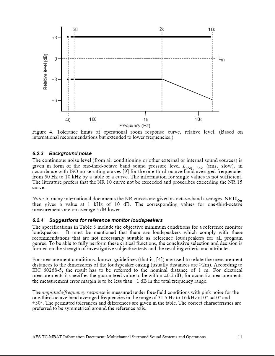

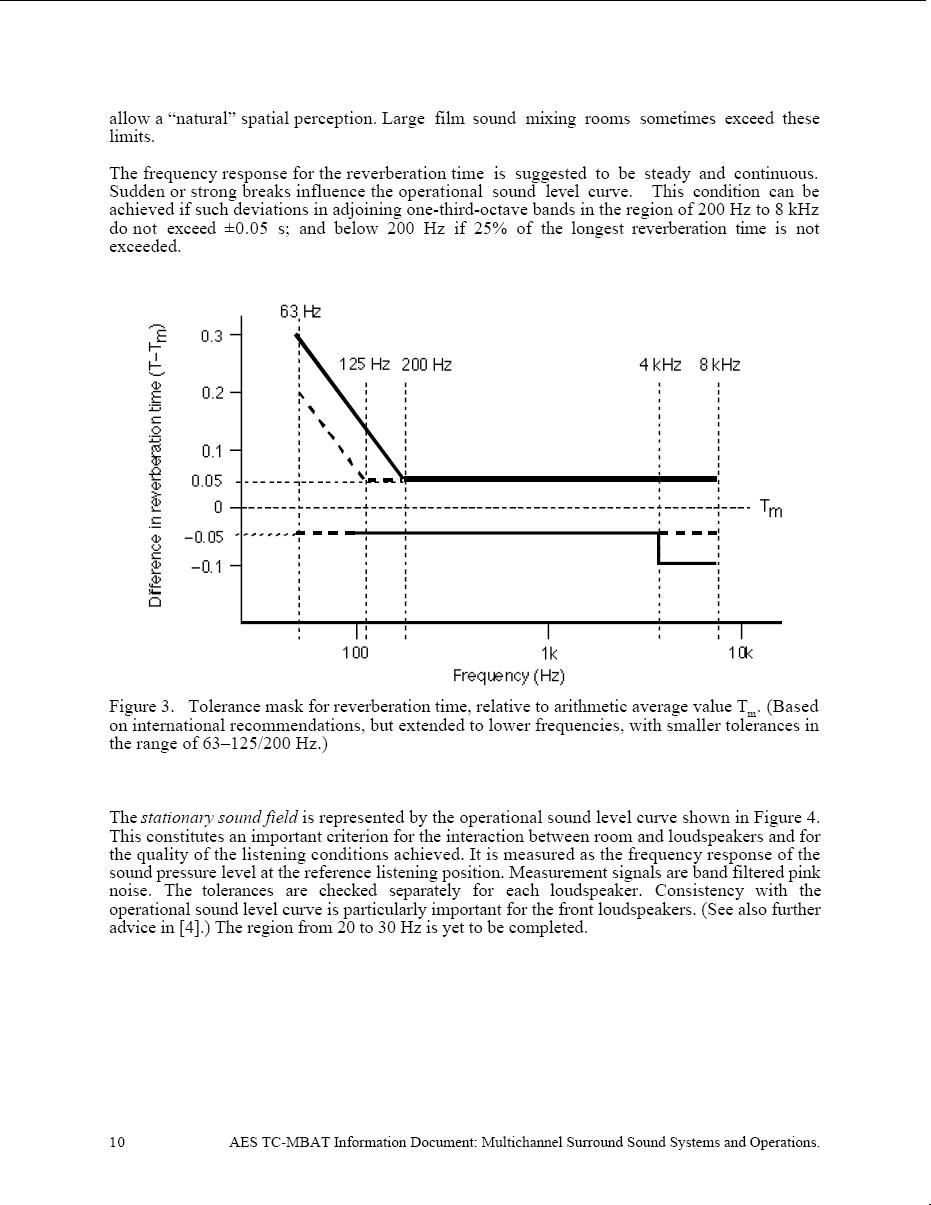

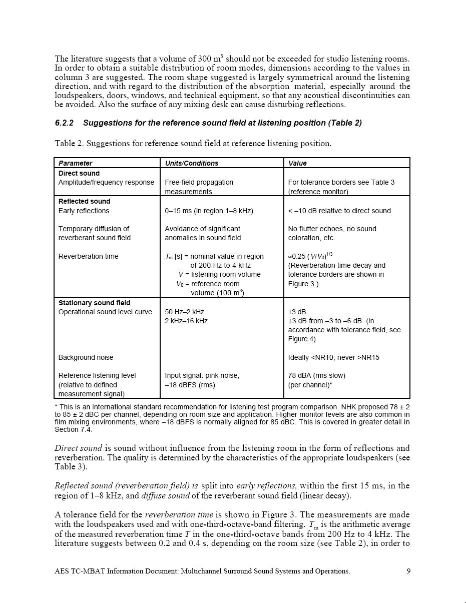

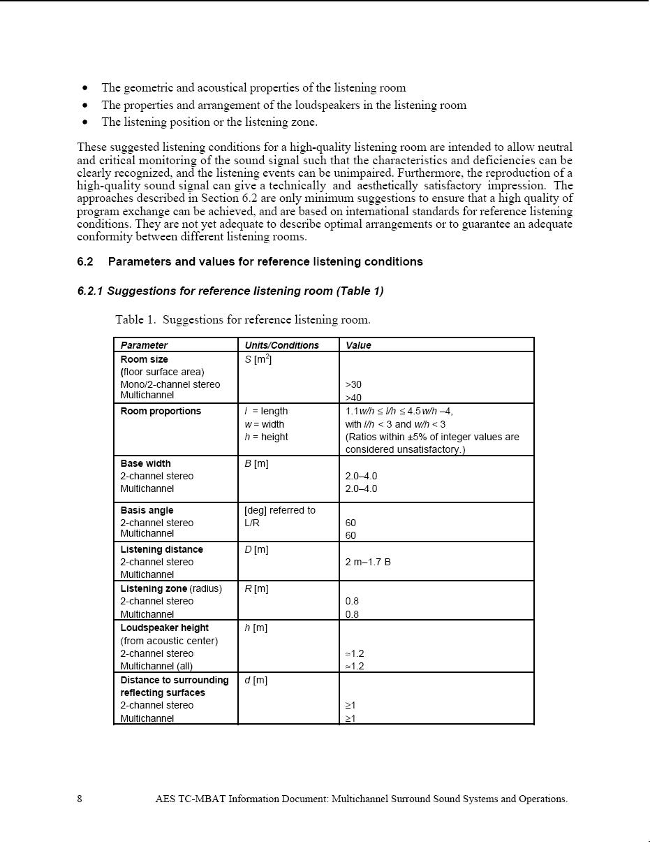

以下是AESTD1001-1-01-10-multichannel surround sound system and operation中关于听音环境的要求:
  发帖心情 Post By:2008-1-20 0:44:44 [显示全部帖子]
  发帖心情 Post By:2008-1-20 0:46:25 [显示全部帖子]
