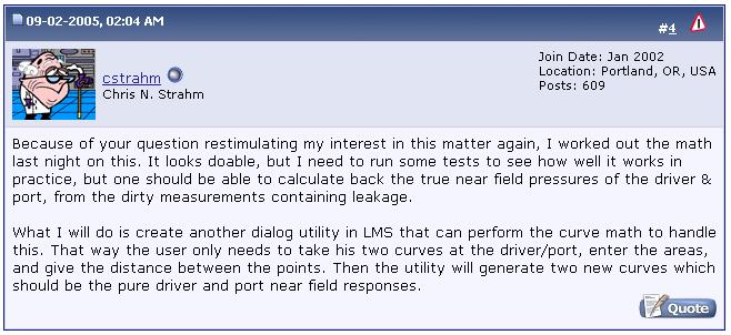

2。如果喇叭离孔太近,那么会有相互影响不过LINEARX正在解决此问题,见他们工程师的帖

这个问题理论上讲应该相加,但是LMS是相减,昨天咨询了LINEARX公司,他们回答了为啥相减,看来和测试系统有关系。大家如果有其他关于LMS测试问题,可以到他们网站上参加讨论
If you are generating the phase using the Minimum Phase transform, there is no polarity reference possible so you have to subtract them. They are both the same polarity. You have to subtract them so that the port curve is treated as opposite phase.
Regards,
Chris N. Strahm / Engrg
LinearX Systems Inc.
9500 SW Tualatin-Sherwood Rd.
Tualatin, OR 97062-8586 USA
Tel: (503) 612-9565
Fax: (503) 612-9344
Web: www.linearx.com
Email: chris@linearx.com
