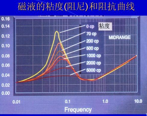

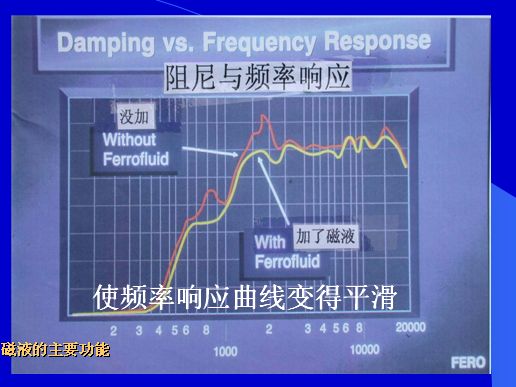

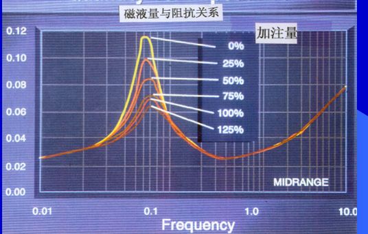

磁液有那些特征?想想就会明白。
有中孔的或漏气的,阻抗峰会怎样?测试比较看看!
  发帖心情 Post By:2008-11-26 22:46:40 [显示全部帖子]
  发帖心情 Post By:2008-11-26 22:48:56 [显示全部帖子]
  发帖心情 Post By:2008-11-26 22:50:41 [显示全部帖子]
  发帖心情 Post By:2008-11-26 22:51:44 [显示全部帖子]
  发帖心情 Post By:2008-11-26 22:52:38 [显示全部帖子]
