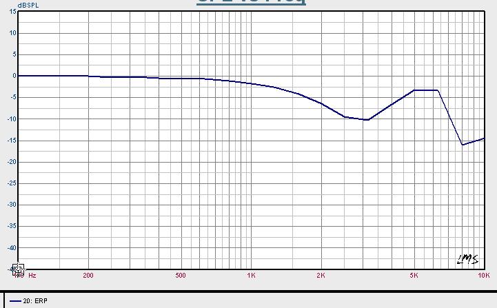

测试中IEC711测出的是DRP的值,type1测试出来的是ERP的值,怎么实现他们的转换,统一成一个值呢?
谢谢!!

  发帖心情 Post By:2008-4-24 9:40:36 [只看该作者]
Frequency    SDE
 (Hz)    (dB)
 92    0.1
 97    0.0
 103    0.0
 109    0.0
 115    0.0
 122    0.0
 130    0.0
 137    0.0
 145    0.0
 154    0.0
 163    0.0
 173    –0.1
 183    –0.1
 193    0.0
 205    0.1
 218    0.0
 230    –0.1
 244    –0.2
 259    –0.3
 274    –0.3
 290    –0.3
 307    –0.2
 325    –0.2
 345    –0.2
 365    –0.4
 387    –0.5
 410    –0.4
 434    –0.6
 460    –0.3
 487    –0.7
 516    –0.6
 546    –0.6
 579    –0.6
 613    –0.6
 649    –0.8
 688    –0.8
 729    –1.0
 772    –1.1
 818    –1.1
 866    –1.2
 917    –1.3
 972    –1.4
 1029    –1.8
 1090    –2.0
 1155    –2.3
 1223    –2.4
 1296    –2.6
 1372    –3.1
 1454    –3.3
 1540    –3.9
 1631    –4.4
 1728    –4.8
 1830    –5.3
 1939    –6.0
 2053    –6.9
 2175    –7.5
 2304    –8.1
 2441    –9.1
 2585    –9.5
 2738    –10.4
 2901    –11.0
 3073    –10.5
 3255    –10.2
 3447    –9.1
 3652    –8.0
 3868    –6.9
 4097    –5.8
 4340    –5.0
 4597    –4.2
 4870    –3.3
 5158    –2.7
 5464    –2.4
 5788    –2.4
 6131    –2.5
 6494    –3.3
 6879    –4.5
 7286    –5.9
 7718    –9.0
 8175    –14.2
 8659    –20.7

  发帖心情 Post By:2008-4-24 9:41:15 [只看该作者]
可以用数值处理的方法转换数据.
