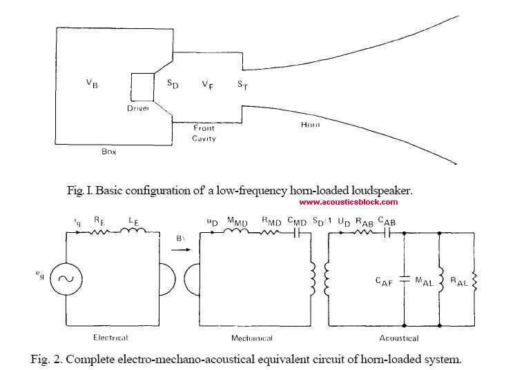

W. Marshall Leach, Jr., received B.S. and M.S. degrees
in electrical engineering from the University of South
Carolina, Columbia, in 1962 and 1964, and a Ph.D. degree in
electrical engineering from the Georgia Institute of
Technology, Atlanta, in 1972.
In 1964 he worked at NASA in Hampton, Virginia. From 1965 to 1968 he served as an officer in the U.S. Air Force.
Since 1972 he has been a faculty member at the Georgia
Institute of Technology where he is presently associate
professor of electrical engineering. His interests are applied
electromagnetics, audio and electroacoustics. and electronic
circuit design.
Dr. Leach is a member of the IEEE, the Audio Engineering
Society, Sigma Xi, Tau Beta Pi, Eta Kappa No, Omicron Delta
Kappa, and Phi Beta Kappa.
Sample article of "Acoustic Bibliography" on www.shackman.reromanus.net
More Speaker know-how on www.shackman.reromanus.net
钟灵
  发帖心情 Post By:2008-12-4 14:24:49 [只看该作者]
可以参照看看.
论文讲的是前加载号筒的等效电路.

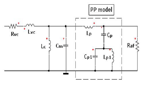

看看这个等效电路  发帖心情 Post By:2009-1-15 21:58:03 [只看该作者]
  • Cp    capacitor representing phase plug – diaphragm air mass (Cp =ρoSdld2/3(Bl)2h)
  • Lp     inductor representing phase plug – diaphragm air compliance (Lp =(Bl)2h/ρoc2Sd)
  • Cp1  capacitor representing phase plug – diaphragm air mass closed to the slot (≈ 1,5Cp)
  • Lp1   inductor representing phase plug – diaphragm air compliance near to the slot (≈0,099Lp)
  • Raf   horn radiation resistance (Raf = (Bl)2ST/ρocSd2)
  • Rvc  voice coil resistance
  • Lvc  voice coil inductance
  • Cm  capacitor representing total diaphragm mass (Cm = MT/(Bl)2)
  • Lc    inductor representing suspension compliance (Lc = (Bl)2CT)
  • ld     maximum sound path length between two adjacent slots
  • MT   diaphragm mass
  • B     magnetic induction
  • l      voice coil length
  • Sd   diaphragm surface
  • h     diaphragm – phase plug distance
  • ST   slot open area at diaphragm side
  • c     sound velocity
  • ρo   air density
