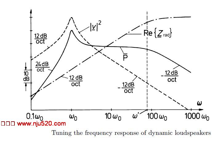

看两个有意义的图.
  发帖心情 Post By:2009-12-3 17:08:10 [只看该作者]
  发帖心情 Post By:2009-12-3 17:08:48 [只看该作者]
  发帖心情 Post By:2009-12-3 17:27:05 [只看该作者]
The mechanic tuning of the loudspeaker usually shifts the main resonance
to the low end of the transmitted frequency range. Spherical waves are predominately
emitted in this frequency range, and, below a limiting frequency
ω', the real part of the radiation impedance, Zrad, increases proportional
to ω^2.

  发帖心情 Post By:2009-12-3 17:28:42 [只看该作者]
Tuning the mechanic resonance to lower frequencies extends the range. The
acceleration, a, of the membrane should be constant to keep the radiated
power independent of frequency since |v^2| ~ 1/ω^2 means |a| = ω|v| = const.
  发帖心情 Post By:2009-12-3 17:31:42 [只看该作者]
Electric equalization using the techniques discussed here can overcome
the mechanic deficiencies of the loudspeaker, but be aware that very large
mechanic forces may be needed, reducing the power efficiency. Monitoring the
movement of the membrane with sensors and controlling the driving force
accordingly is called motional feedback and has been successful at reducing
distortions – particularly at the lower end of the frequency range.

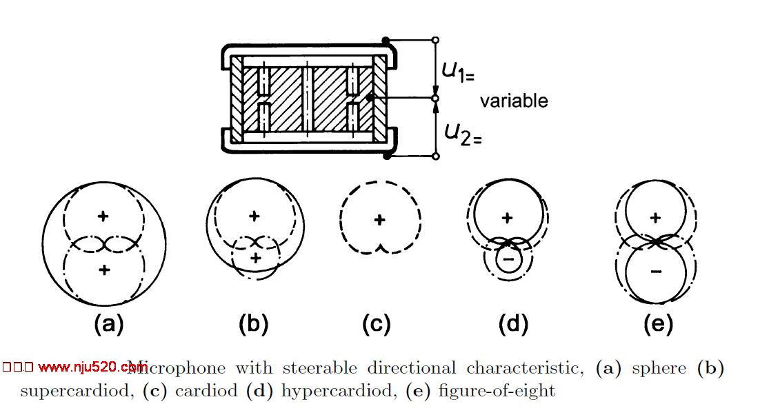

图片点击可在新窗口打开查看此主题相关图片如下:microphone with steerable directional.jpg
  发帖心情 Post By:2009-12-3 17:43:26 [只看该作者]
可调指向性因子麦克风

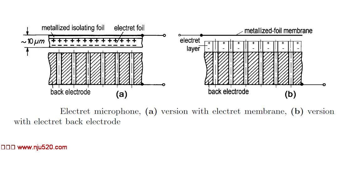

图片点击可在新窗口打开查看此主题相关图片如下:electret microphone.jpg

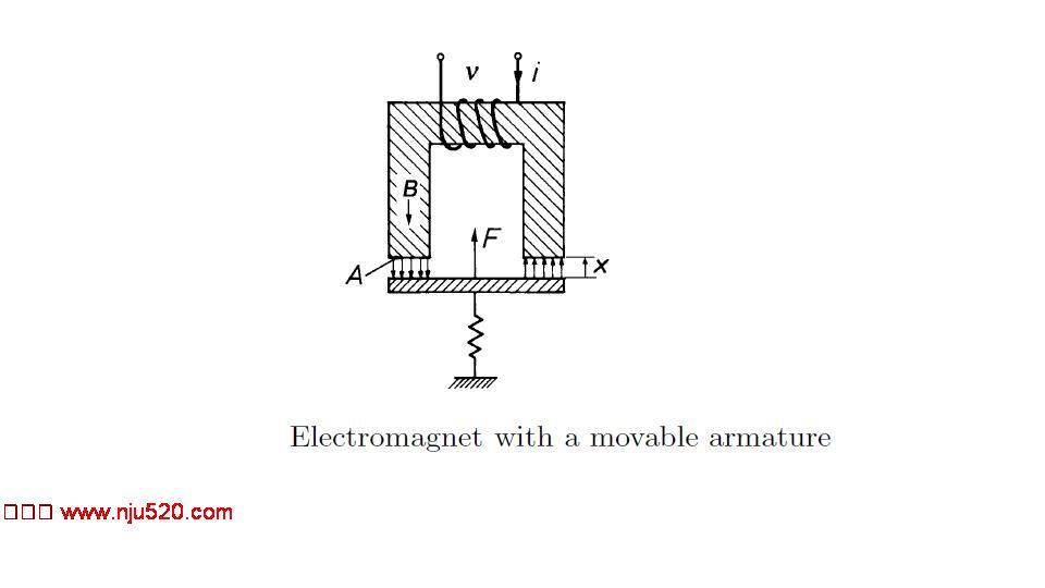

  发帖心情 Post By:2009-12-3 18:08:29 [只看该作者]
公式和理论推导,就不贴了.
动铁的计算和仿真都是可行的.
