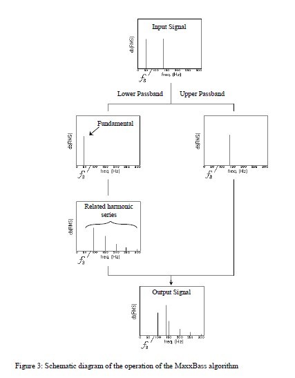

其实就是一种激励器,先滤掉低频,再增加“低频”的谐波。
前几天看到一篇英文的介绍,图文并茂,可惜没复制下来。
MAXXBASS SRS/WOW等都有此功能。

分谐波是会出现的.
但听感问题,低音增强效应,利用的不是分谐波而是二次三次及高次谐波和心理声学效应.
说得难听点,是人为增加谐波来造成低音增强的错觉, 当然,这里的"度"必需把握好.
人耳可以听到1%的失真!但若谐波的份量没达到一定程度(如1%不到),低音增强效果可能又值得怀疑.
所有相关资料里,细节(数据)都没讲清楚,估计是专利问题吧. 若大家都清楚了,专利就没效益了(原理不复杂).

AES上的一篇文章摘录.
  发帖心情 Post By:2010-11-17 15:14:13 [显示全部帖子]
The Effect of the MaxxBass1 Psychoacoustic Bass Enhancement
System on Loudspeaker Design
1 MaxxBass is a patented technology of Waves Ltd.
Daniel Ben-Tzur
R & D Dept.
Waves, Tel Aviv, Israel
dbentzur@kswaves.com
http://www.waves.com
Martin Colloms
Colloms Electroacoustics
London, England
Abstract
The MaxxBass signal processing algorithm is introduced as a new factor in low
frequency loudspeaker design. Exploiting the phenomenon of the ‘missing
fundamental’, MaxxBass stimulates a low frequency auditory sensation without the
need to produce the whole low frequency range. A brief review is made of the
performance limitations in the bass reproduction of small speakers with emphasis
upon the difficulty of efficiently lowering the resonant frequency. The breakdown in
the ear’s logarithmic sensitivity at low frequencies is identified as a factor for
satisfactory bass performance. With MaxxBass correctly implemented, gains in
apparent low frequency extension of up to one and a half octaves are reported.
Example applications of MaxxBass are explored.
