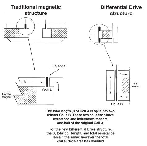

看来大家有很多疑问,朋友给了一些资料,看能不能说明问题。
这个是JBL的一款产品

下面是这款产品、这种设计的特性介绍,我试试抛砖引玉:
A. Better heat dissipation. The physical separation of the two coils can be adjusted for optimum heat transfer from each coil to the outer structure of the driver. In addition, the total surface area of the two coils has doubled,creating twice the heat radiation capability.
更好的散热性。
B. The new voice coil arrangement will have less effective inductance than the standard one, since the reversely wound coils will have negative mutual inductance between them.
This translates into a more uniform impedance curve and extended output at higher frequencies.
降低电感。阻抗曲线更平滑一致。
C. The compact nature of the Differential Drive motor structure requires much less iron in the magnetic return path. If NIB (neodymium-iron-boron) magnet material is used, a Differential Drive transducer can weigh as little as one-third the equivalent traditional ferrite design. This advantage shows up primarily in overall system weight and ease of installation.
钕铁硼,更轻。
D. The structure is inherently shielded magnetically, especially at 90 degrees away from the axis of the structure. The result is very little stray magnetic field interference with CRT video systems.
更小的磁场干扰。

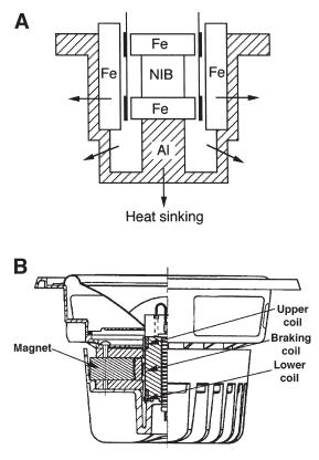

E. Nesting the small overall magnet structure in a large aluminum heat sink results in efficient dissipation of heat from the coils, as shown in Figure 3A. Aluminum, with its high specific heat and low thermal resistance, is the ideal material for this. The section view shown at B illustrates the use of ferrite magnet material
in the design of a Differential Drive transducer which includes a braking coil, as discussed in Section 5.
材料说明。
F. Design flexibility. The two voice coils may be driven in electrical series or parallel, depending on the system design impedance. Typical applications call for a nominal 8-ohm driver, with two 4-ohm coils operating in electrical series.
设计灵活。
G. Push-pull operation. In an analogy to Class AB operation of a power amplifier, the motion a Differential Drive system reduces even-order distortion components, due to the exact symmetry of the motor structure along its operating axis.
降低失真。

其实这是两个问题:
第一个问题:这种方法有什么作用,是不是能抵消感生电动势,是不是能降低电感、产生电阻负载特性?等等。
第二个问题:如果可以,那么有什么效用,是不是能提高转换效率、提高多少,是不是能降低失真度、降低多少?等等。
有实干精神的人,不妨想办法做一个出来,再测测灵敏度和失真度等等,用实践来检验,不是更说明问题吗?
