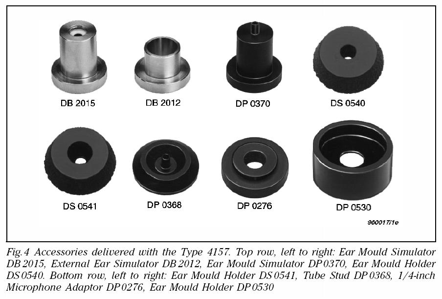

Accessories
A number of adaptors, which can be
mounted flush with the reference
plane, are delivered with the Ear Simulator,
both for mounting a wide range
of earphones in current use and for
special measurements on the Ear Simulator
itself. See Fig. 4.
The Ear Mould Simulator DB 2015 is
for testing button-type insert earphones.
The External Ear Simulator
DB2012 simulates the whole of the external
ear canal, and may be used to
calibrate the measuring chain with
the Pistonphone Type 4228. When
used for this purpose the calibration
level produced by the pistonphone is
0.7 dB lower than when calibrating a
microphone because of the much larger
volume of the Ear Simulator cavity.
The Ear Mould Simulator DP 0370 is
for testing behind-the-ear hearing
aids. For testing ITE (in the ear) hearing
aids, Adaptor DP0530 may be
used. The Ear Mould Holder DS 0540
is used to mount small ear moulds
and CIC (completely in the canal)
hearing aids on the Ear Simulator.
DS 0541 is similar to DS 0540 but for
larger moulds. The Tube Stud DP 0368
is for modular hearing aids.
Adaptor DP 0276 accepts a 1/4 inch
microphone to be used as a sound
source for testing the Ear Simulator.
The adaptors are secured by an internally
threaded collar DP 0286.

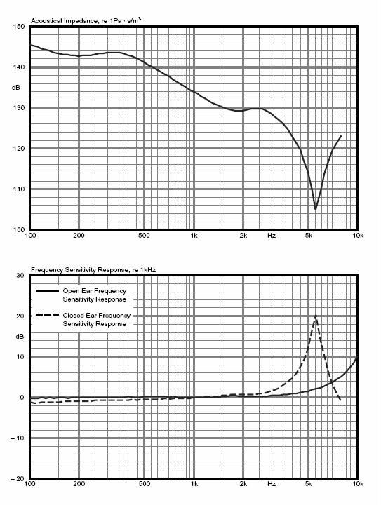

  发帖心情 Post By:2007-1-23 23:19:54 [显示全部帖子]
TYPE4185响应:
  发帖心情 Post By:2007-1-23 23:20:53 [显示全部帖子]

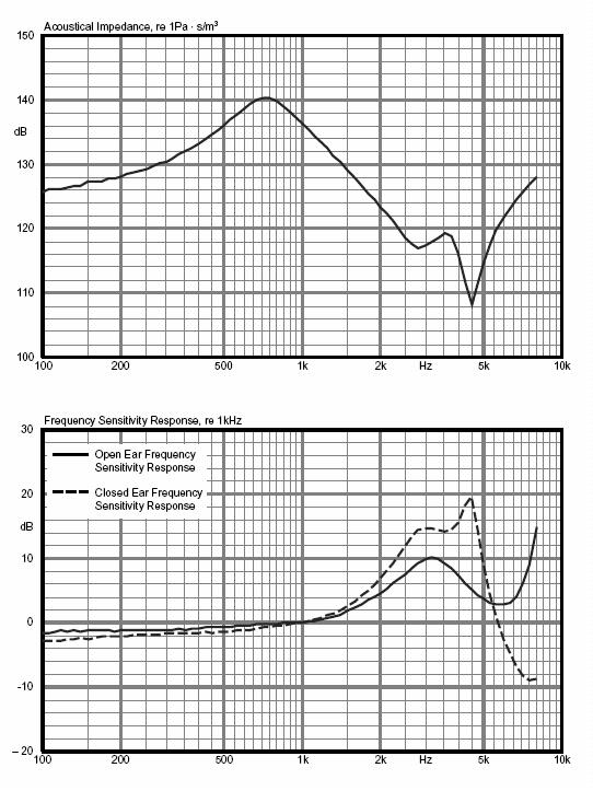

TYPE4195响应:
