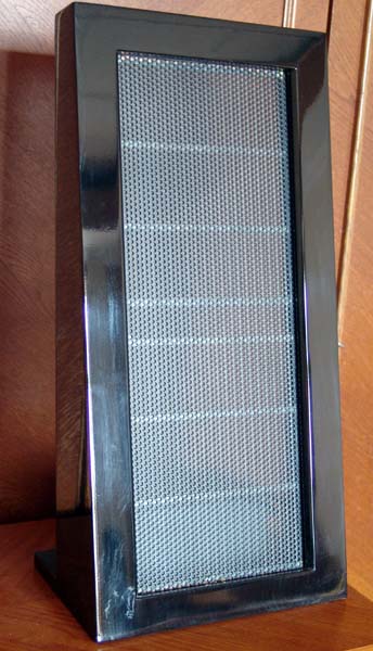

超级音响---静电扬声器  发帖心情 Post By:2006-9-25 10:20:04 [只看该作者]
spk888
加好友 发短信 电声工作者
  发帖心情 Post By:2006-9-25 11:08:03 [只看该作者]
说说怎么样的超级法!图片点击可在新窗口打开查看

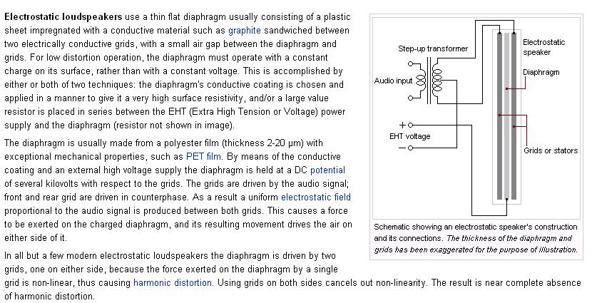

  发帖心情 Post By:2006-11-1 11:52:16 [只看该作者]

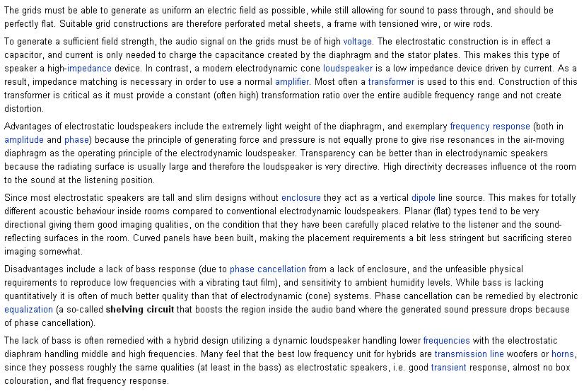

  发帖心情 Post By:2006-11-1 11:55:46 [只看该作者]
Disadvantages include a lack of bass response (due to phase cancellation from a lack of enclosure, and the unfeasible physical requirements to reproduce low frequencies with a vibrating taut film), and sensitivity to ambient humidity levels. While bass is lacking quantitatively it is often of much better quality than that of electrodynamic (cone) systems. Phase cancellation can be remedied by electronic equalization (a so-called shelving circuit that boosts the region inside the audio band where the generated sound pressure drops because of phase cancellation).
The lack of bass is often remedied with a hybrid design utilizing a dynamic loudspeaker handling lower frequencies with the electrostatic diaphram handling middle and high frequencies. Many feel that the best low frequency unit for hybrids are transmission line woofers or horns, since they possess roughly the same qualities (at least in the bass) as electrostatic speakers, i.e. good transient response, almost no box colouration, and flat frequency response.

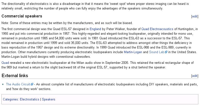

The directionality of electrostatics is also a disadvantage in that it means the 'sweet spot' where proper stereo imaging can be heard is relatively small, restricting the number of people who can fully enjoy the advantages of the speakers simultaneously.
  发帖心情 Post By:2006-11-1 11:56:21 [只看该作者]
缺点上面也介绍了!
