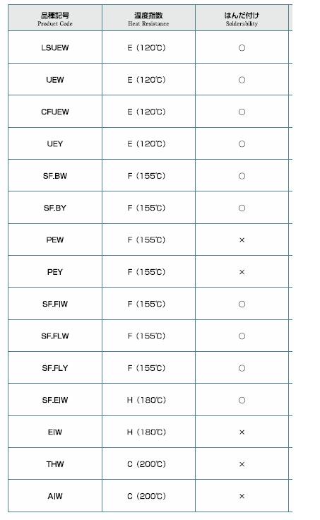

找到温度特性了:
  发帖心情 Post By:2006-7-6 23:48:27 [显示全部帖子]
SF.EIW:
This wire is the same as conventional polyester-imide enameled copper wire except solderability has been added to eliminate terminal preparation work.
Features
Solderable at 460 , terminal preparation work eliminated.
Applicable standards :
JCS 394 "Solderable enameled round copper winding wires"
Applications :
Small motors, transformers.
Grade of heat resistance and range of manufacture
Code Grade of Heat Resistance Range of Manufacture (mm)
UL-Approved
Class 0 Class 1 Class 2 Class 3
SF.EIW H(180) 180 0.10
0.50
0.08
0.50
0.07
0.50
0.07
0.30
没法在小喇叭里用啊!

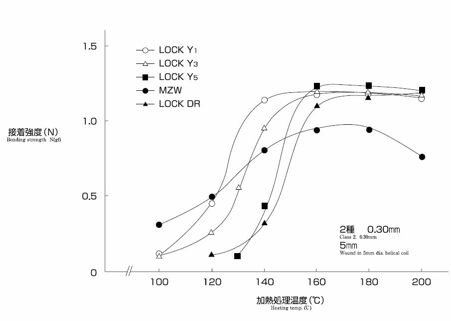

Features
As it is thermoset, the bonding layer exhibits excellent adhesion at high temperatures.
Two processes are necessary-fusion and setting.
Not solderable.
Bonding :
After forming by a solvent (methyl alcohol or denatured alcohol) or by heat, heat the coil at 180220 for 30 minutes or more for setting.
TOTOKU Standard.
Applications :
High output voice coils, automobile fans, small motors.
Range of manufacture (Case of combination with PEW)
Code Media of Fusion Range of Manufacture (mm)
Solvent Hot Air Elec.Current Class 0 Class 1 Class 2 Class 3
SVW - 0.06
0.55
Normally used to polyester enameled copper wire (PEW).
UL-approved temperature :
PEW (155)

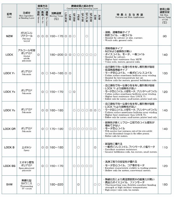

  发帖心情 Post By:2006-7-7 0:01:32 [显示全部帖子]
  发帖心情 Post By:2006-7-7 0:12:48 [显示全部帖子]
  发帖心情 Post By:2006-7-7 0:21:27 [显示全部帖子]
由此看来,UEHTW线耐温只有100度(接着强度确实不错):
UE 120度
LOCK Y1 100度
UEHTW = UE+LOCK Y1(不知理解有没错?)
