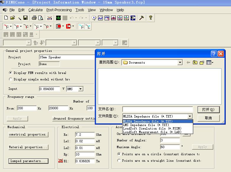

  发帖心情 Post By:2007-4-12 11:10:45 [只看该作者]
FINECONE可以导入MLSSA和LMS的阻抗和频响曲线。
其电学模型(阻抗)也是类似MLSSA的。
帅哥,在线噢!
  发帖心情 Post By:2007-4-12 11:14:03 [只看该作者]
1. Re (ohms). Note this can be set to Zmin (minimum impedance over Fs) to better simulate the actual impedance and thereby the actual SPL level. The red speaker symbol , indicates import from FINEMotor.
2. The standard model has two inductors. Le1 (mH) is a serial inductor.
3. Le2 (mH) is the second serial inductor, which is paralleled by a resistor (Rp).
4. Rp (ohms) is the parallel resistor over Le2.
5. Bl is the force factor of the driver motor.
6. The advanced setting is for importing a measured impedance curve.
