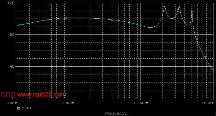

例如入耳式耳机的前腔直径和导声管的口径接近时,此时的前腔是按照前腔进行设计还是按照导声管来设计?
很有意义的问题.

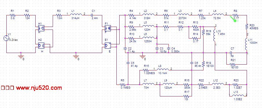

重新查阅了一些资料,并仿真计算了一番,结果有很大变化.

Only small mechanical structures with dimensions less than 1 cm can be modelled by lumped components in all case, with only low loss of accuracy at these frequencies ( less than 4kHz).

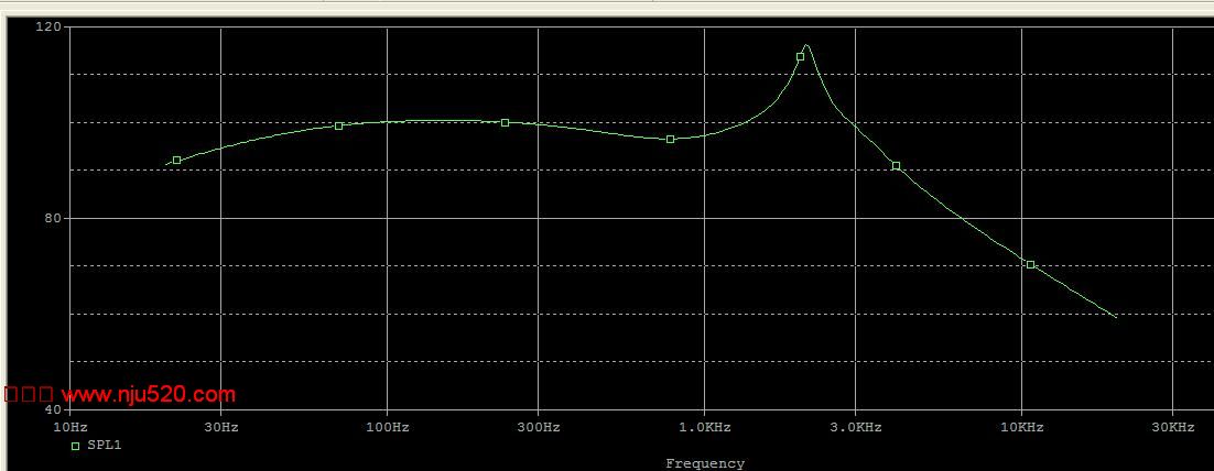

  发帖心情 Post By:2010-1-30 14:23:00 [显示全部帖子]
看看不同之处!
