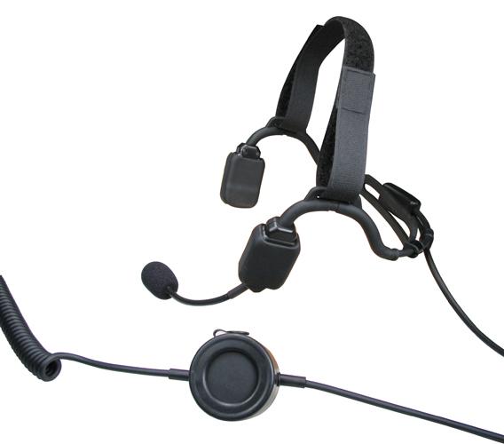

  发帖心情 Post By:2014-3-18 16:04:15 [只看该作者]
Product Features:
Military bone conduction tactical headset
Features:Through the temporal bone on both sides of cheeks transfer sound signals to the brain,effectively
reduced background noise.
Solved unable to communication problems under high noise environment.
Do not rely on eardrum:Let your ears to breathe protect your eardrum.Be alert on the surrounding
environment.
Apply to all kinds of helmet:All kinds of military helmet,can compatible with bulletproof helmet,too.
Adjust firmness freely:Adjust the firmness of the headset according to head size.More comfortable
and strong.
Optional anti-noise earplugs:Can be equipped with anti-noise earplugs to listen very clear voice under high noisy environment.
Super waterproof resistant:Suitable for all kinds of complicated application environment.
Swat, Riot police,Sniper,Army and other special occasions.

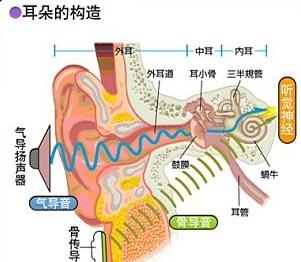

骨传导技术
    骨传导扬声器是一种使声音通过骨骼直接将振动传导致人耳蜗内的淋巴,让人听到周围声音的一种技术,目前这种技术已经得到了越来越广泛的应用。由于骨传导扬声器的主要传输途径不是平常的空气声传导途径,所以能保证佩戴者在通讯的同时听见周围的声音,而且能让因耳道受损而导致听力损伤的使用者听见声音。
   骨传导麦克风是麦克风直接拾取人说话时的振动信号,将振动信号转换为电信号,实现声电转换。由于骨传导其特殊的转化机理,所以能有效地消除周围环境噪音。而当人说话的时候,喉咙、颚骨、头骨等处都会产生振动,因此,骨传导麦克风能被佩戴到头部的任何地方。
