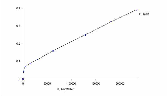

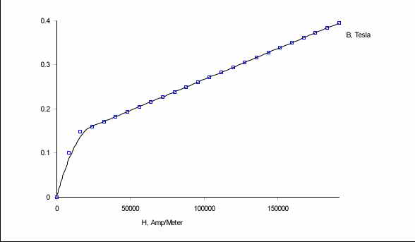

  发帖心情 Post By:2007-2-10 17:25:24 [只看该作者]
  发帖心情 Post By:2007-2-10 17:25:55 [只看该作者]
  发帖心情 Post By:2007-2-10 17:32:50 [只看该作者]
Y30相当于Ceramic5
Y30H-1相当于Ceramic8
Y20相当于Ceramic6
  发帖心情 Post By:2007-2-10 17:34:58 [只看该作者]
FEMM里只有Ceramic5和Ceramic8(BH图就是上图的两曲线),可以导入DAT文件(可以用文本编辑)

  发帖心情 Post By:2007-11-5 15:30:06 [只看该作者]
<BeginFolder>
<FolderName> = "Ceramic Magnets"
<BeginBlock>
<BlockName> = "Ceramic 5"
<Mu_x> = 1.8859999999999999
<Mu_y> = 1.8859999999999999
<H_c> = 191262
<H_cAngle> = 0
<J_re> = 0
<J_im> = 0
<Sigma> = 0
<d_lam> = 0
<Phi_h> = 0
<Phi_hx> = 0
<Phi_hy> = 0
<LamType> = 0
<LamFill> = 1
<NStrands> = 0
<WireD> = 0
<BHPoints> = 25
 0 0
 0.10034800000000001 8233.8839250000001
 0.14876 16191.633925
 0.15992100000000001 24149.383924999998
 0.17108200000000001 32107.133924999998
 0.18224399999999999 40064.883925000002
 0.19340499999999999 48022.633925000002
 0.204566 55980.383925000002
 0.215728 63938.133925000002
 0.22688900000000001 71895.883925000002
 0.23805000000000001 79853.633925000002
 0.24921099999999999 87811.383925000002
 0.26037300000000002 95769.133925000002
 0.271534 103726.883925
 0.28269499999999997 111684.633925
 0.29385600000000001 119642.383925
 0.30501800000000001 127600.133925
 0.31617899999999999 135557.883925
 0.32734000000000002 143515.633925
 0.338501 151473.383925
 0.349663 159431.133925
 0.36082399999999998 167388.883925
 0.37198500000000001 175346.633925
 0.38314700000000002 183304.383925
 0.39430799999999999 191262.133925
<EndBlock>
  发帖心情 Post By:2007-11-5 15:30:42 [只看该作者]
<BeginBlock>
<BlockName> = "Ceramic 8"
<Mu_x> = 1.4384600000000001
<Mu_y> = 1.4384600000000001
<H_c> = 233568
<H_cAngle> = 0
<J_re> = 0
<J_im> = 0
<Sigma> = 0
<d_lam> = 0
<Phi_h> = 0
<Phi_hx> = 0
<Phi_hy> = 0
<LamType> = 0
<LamFill> = 1
<NStrands> = 0
<WireD> = 0
<BHPoints> = 9
 0 0
 0.040029000000000002 1488.09925
 0.069106000000000001 5665.9179999999997
 0.087951000000000001 15231.1335
 0.11024 30247.407749999998
 0.15995000000000001 63009.464500000002
 0.24912000000000001 128493.78925
 0.32113999999999998 180339.326275
 0.39145000000000002 233567.92025
<EndBlock>
