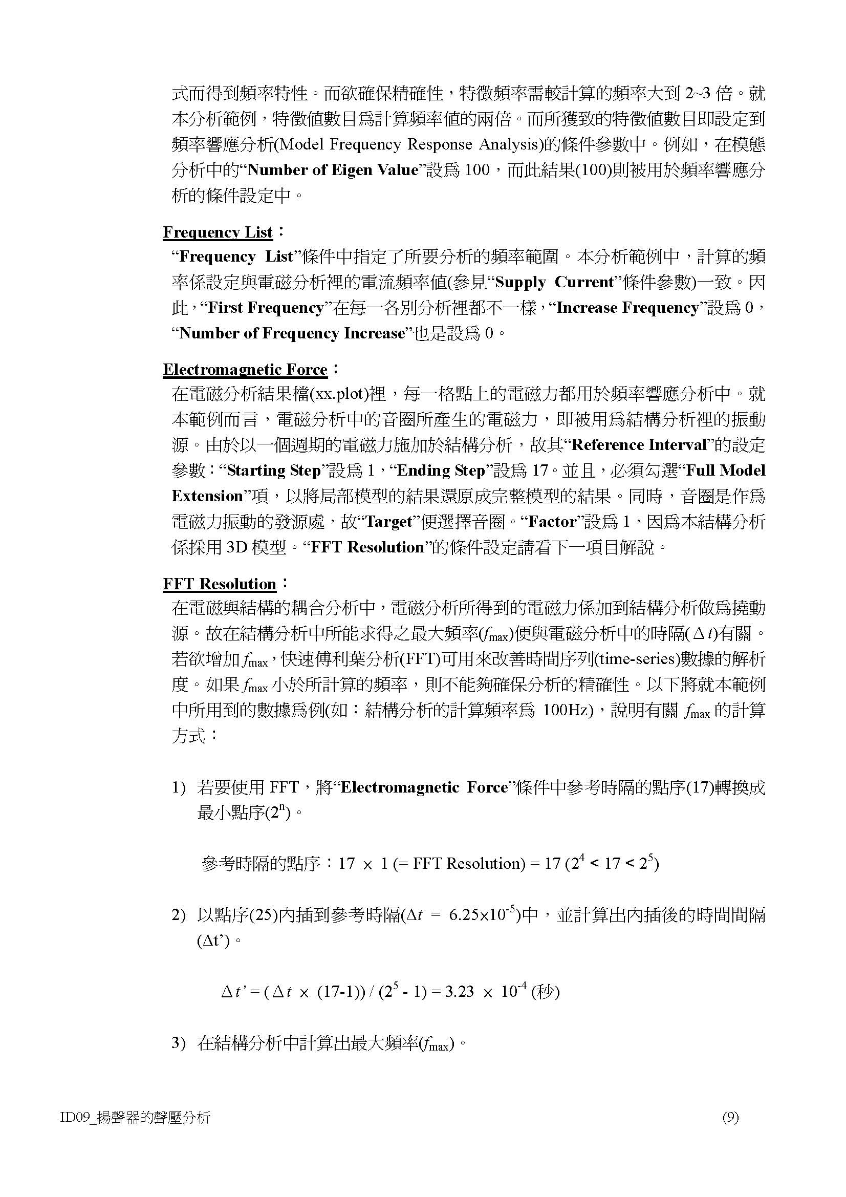

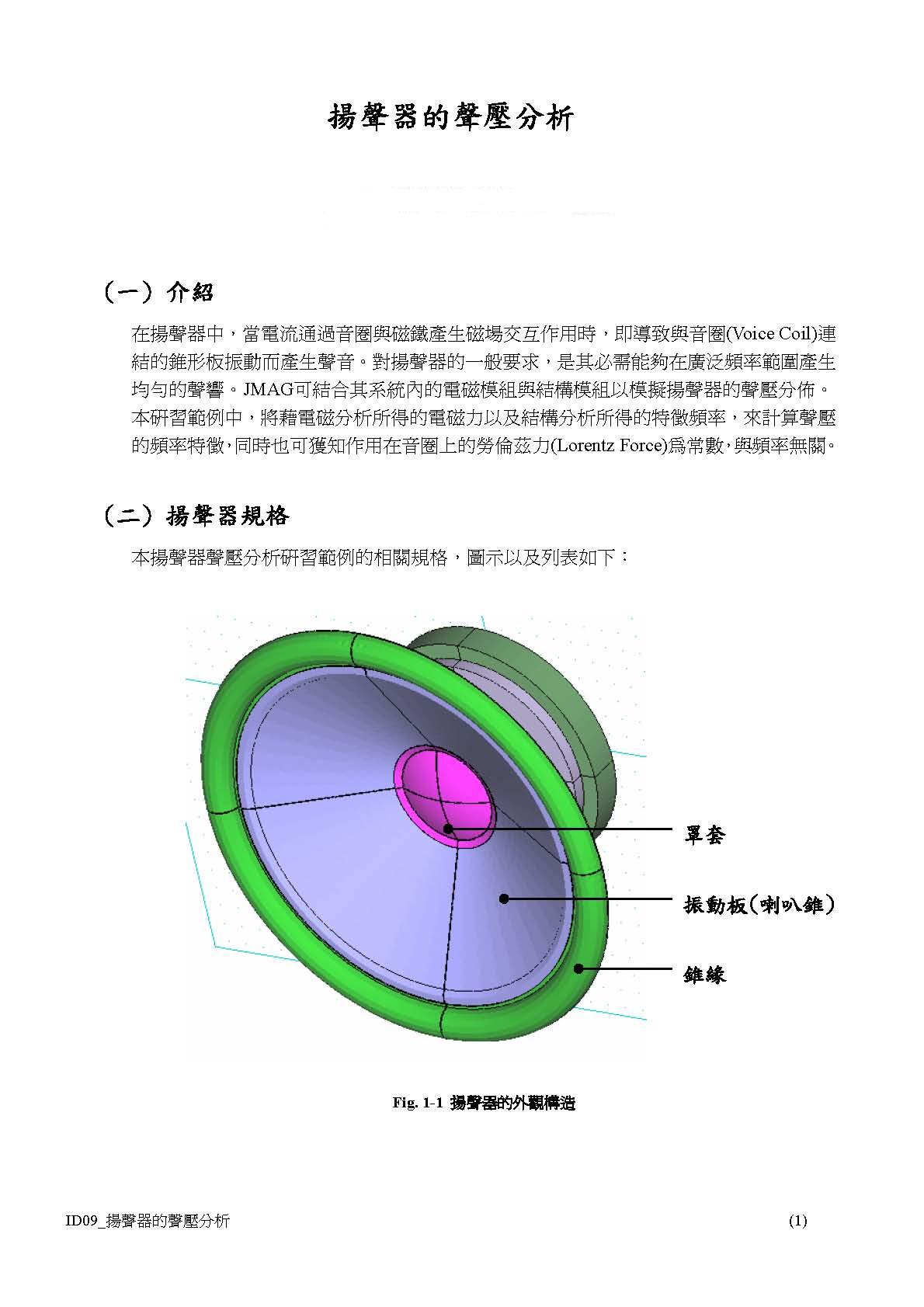

久违了,这次搬来了很多砖头,别闪啊,呵呵

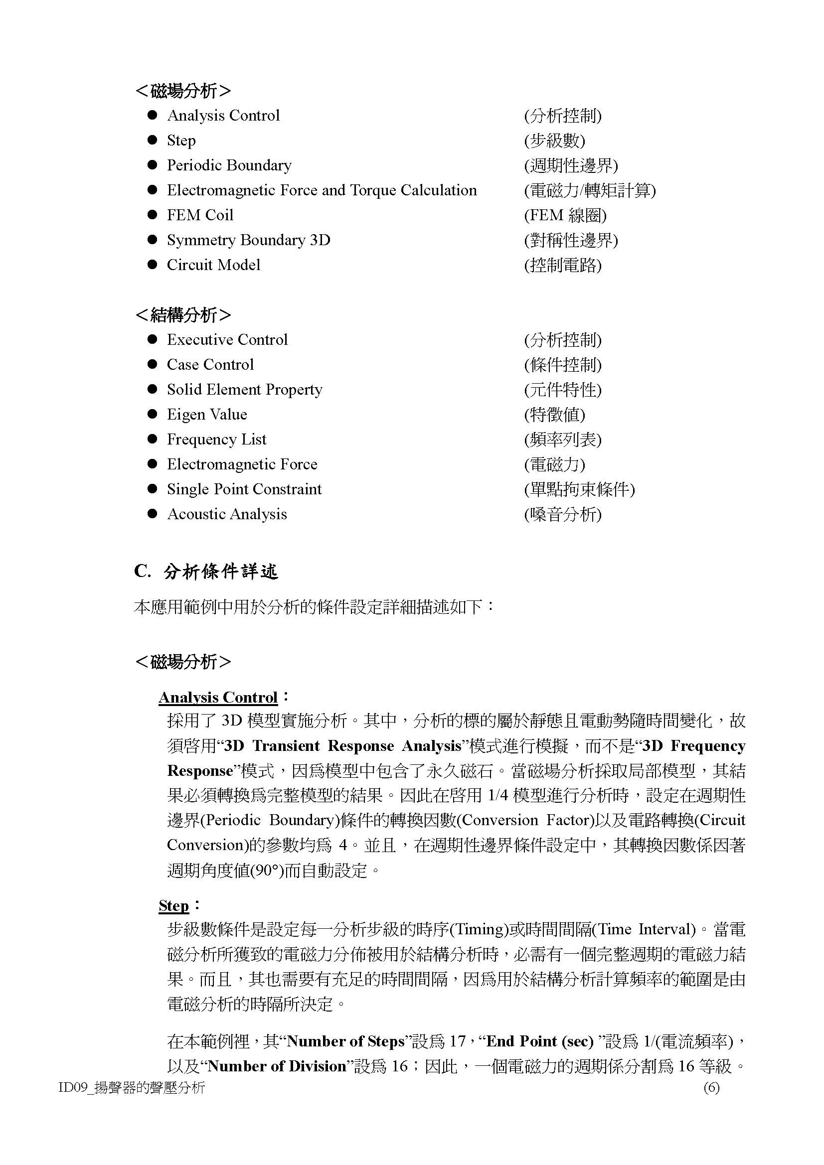

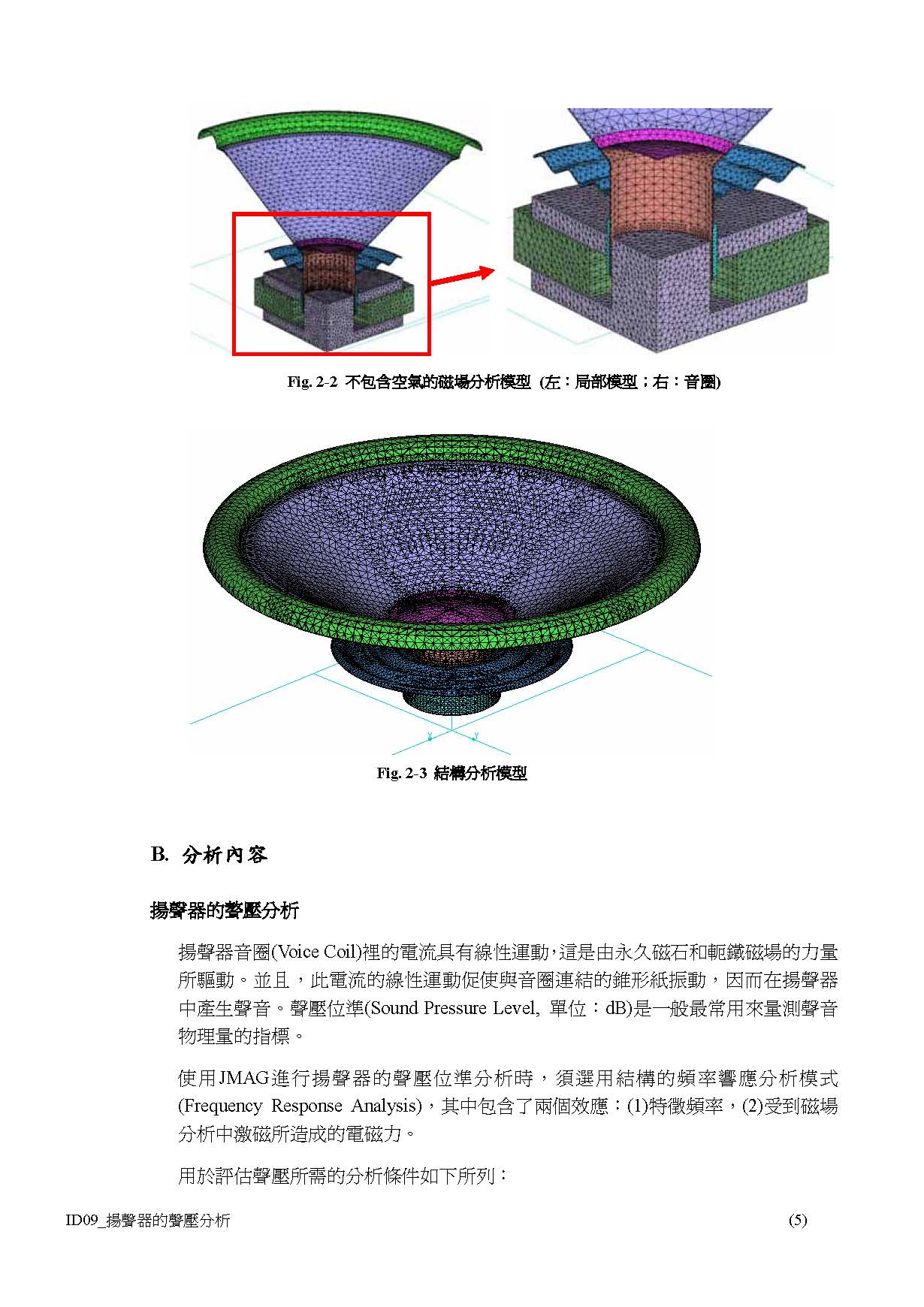

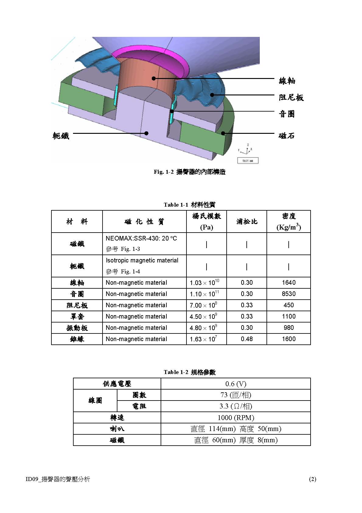

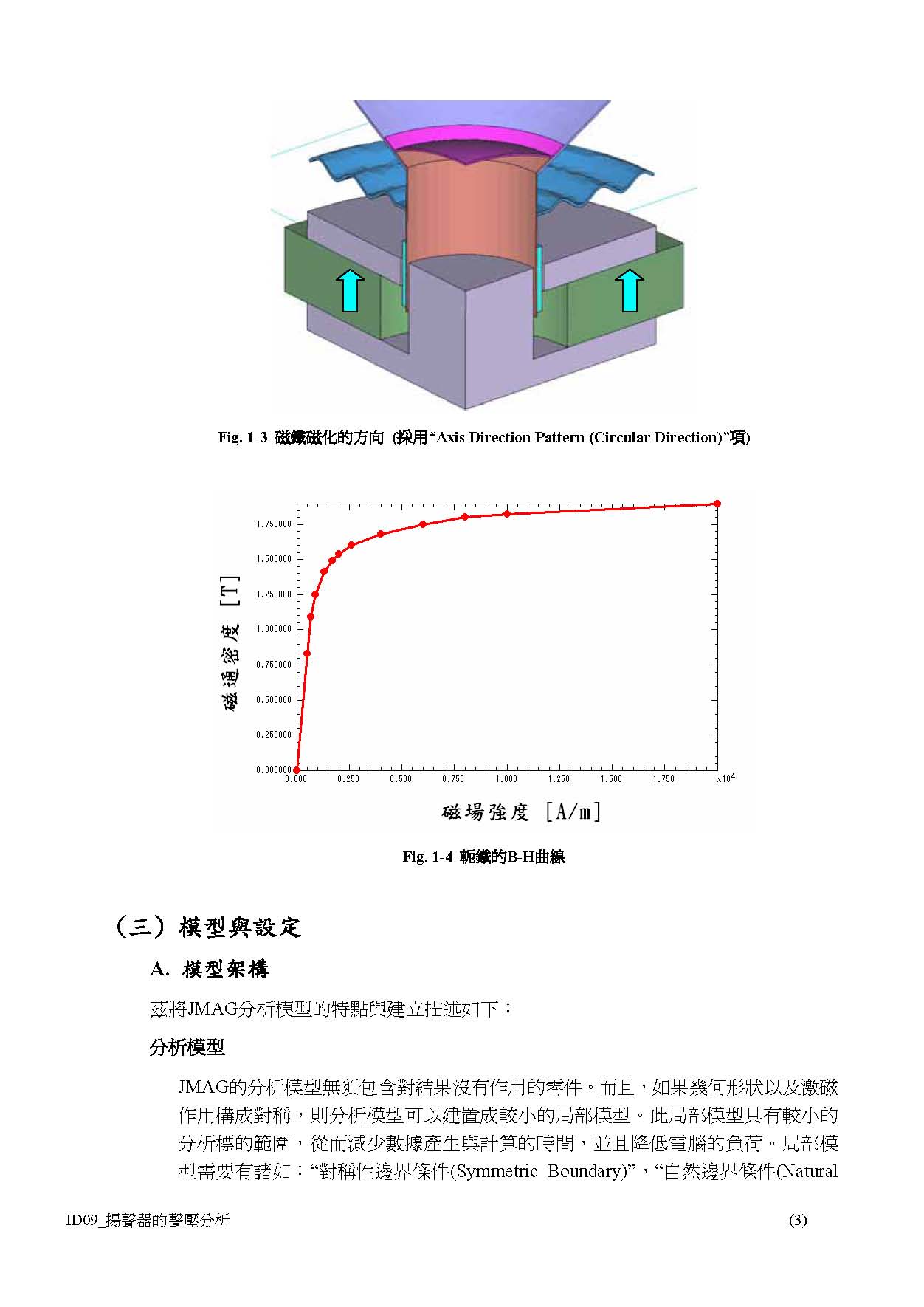

非常好的讨论内容,就是看的不清楚,是否可以怎么处理下让大家看清楚些就好了。
由于看不清楚,不知道是否涉及声功率压缩、分割振动等方面的问题吗?比较关心这些问题。

把图片放大些!很清楚!

台湾人编的某软件教程?

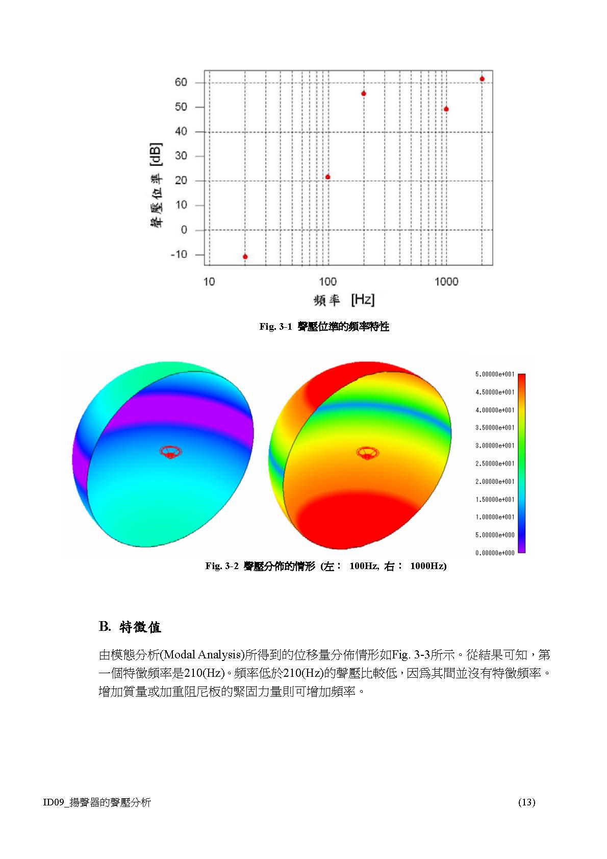

图片点击可在新窗口打开查看 Sound Pressure Level
Sound pressure level at the front center of the loudspeaker is compared for the different frequencies.
Sound pressure level is found to be low at the frequency below 200(Hz).
Sound pressure is determined by the eigenfrequency since the Lorentz force is constant regardless of frequency.

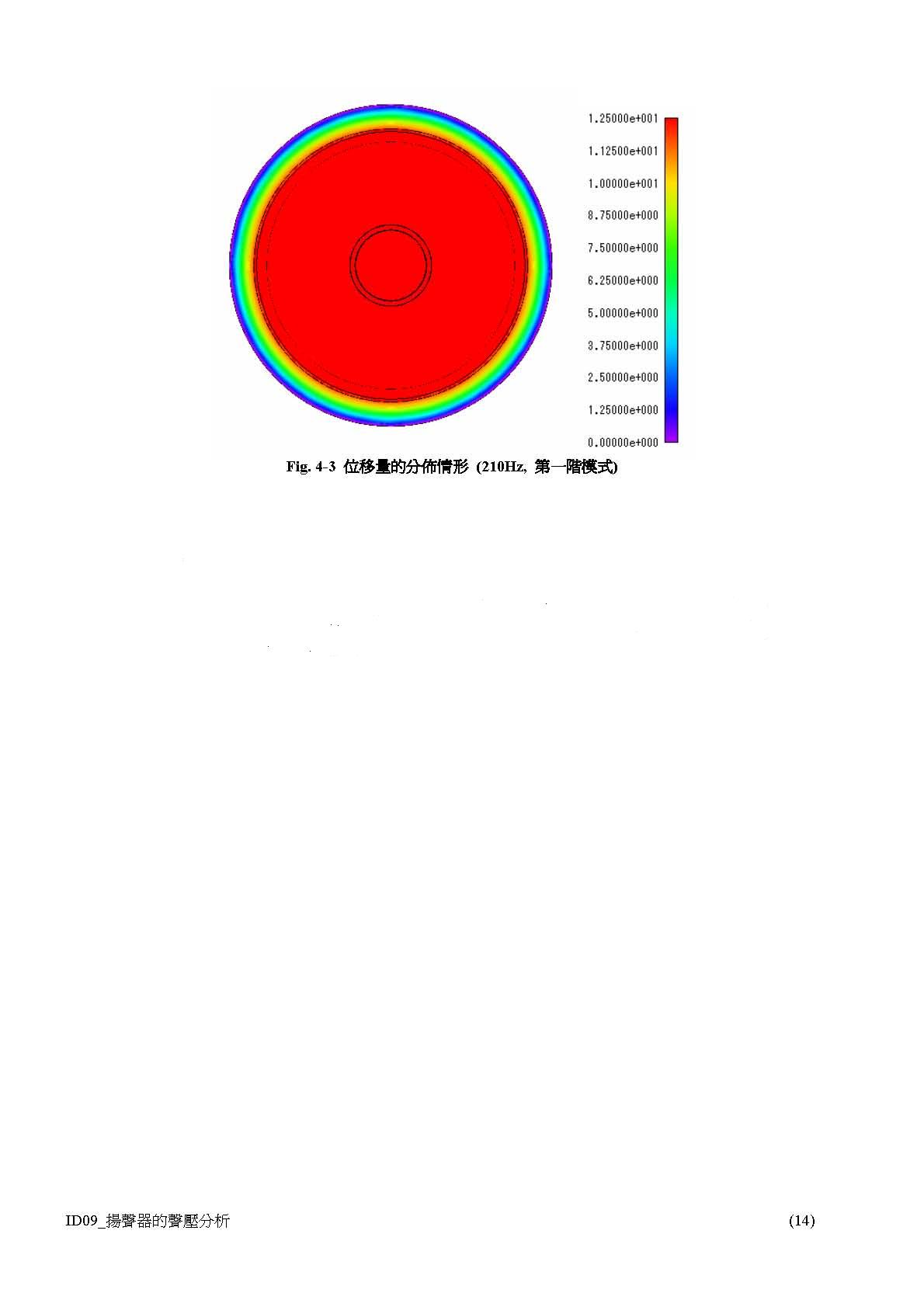

图片点击可在新窗口打开查看 Eigenvalue Analysis
As a result of an eigenvalue analysis, 210(Hz) is obtained for the first eigenfrequency.
To increase the sound pressure level at the frequency below 200(Hz), the first eigenfrequency needs to be decreased.
The eigenfrequency may be lowered by increasing the mass or using a damper.
