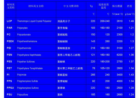

最好能包括材料的常用厚度以及相对应的顺性、连续使用温度、玻璃转化温度和杨氏模量,谢谢!

Abbr. Polymer name Product name Vendor Density
(g/cm3)
E module
(N/mm2)
H2O abs.
24h (%)
Tg
(°C)
M.P.
(°C)
Long term working temperature (°C) Thickness
(μm)
Comments
PC(cast) Polycarbonate Polkalon Coloprint-techfilms 1.2 2100 0,12-0,5 145 220  -60~120 10-100 reference
PC(extruded) Polycarbonate PC-801 Longhua(China) 1.2 2100 <0.330 145 220  -60~120 20-100 Not uniform thickness
PAR PolyArylate Ardel Coloprint-techfilms 1.21 2070 0.26 193 330
-350
<180 2 - 75 Higher thermal forming
temperature than PC
PEI PolyEtherImide Ultem Mitsubishi  1.28 3310 0.25 215 365 <171 12 - 100 Cheaper than PAR, easy to form
PPS PolyPhenylene Sulfide Techtron Toray 1.35 2965 0.01 150 285 <218 12 - 100 Used in other speakers, hard to be stretched
PEN Polyethylenenapthalate Teonex Teijin Dupont 1.36 6080 0.3 121 269 <160 1 - 50 Too high E module

All conventional materials except PET which can survive between -60 to 85 degree,depends your application .
