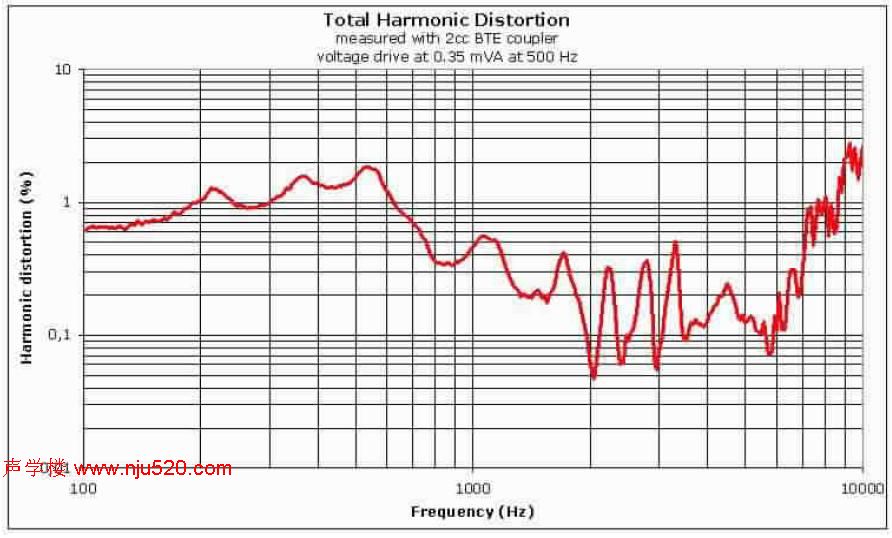

1.The acoustic load consists of a BTE tube (8 mm x 1 mm ID + 28 mm x 1.5 mm ID
+ 25 mm x 2 mm ID + 18 mm x 3 mm ID) into a 2 cc coupler.

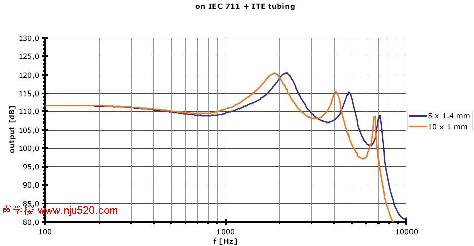

2.The acoustic load consists of ITE tubing 10 x 1 mm (or 5 x 1.4 mm) and a 2cc volume.

3.Receivers are usually specified on a 2cc coupler with BTE tubing or ITE tubing. Today there
are better representations of the human ear such as the B&K 4157 (IEC-711). In practice the
tubing may also be different. For example, in an ITE configuration the tube may be shorter
and wider than the 10 x 1 mm used for specifications.

看这个曲线应该是声扬或者楼氏的动铁式受话器啊!
