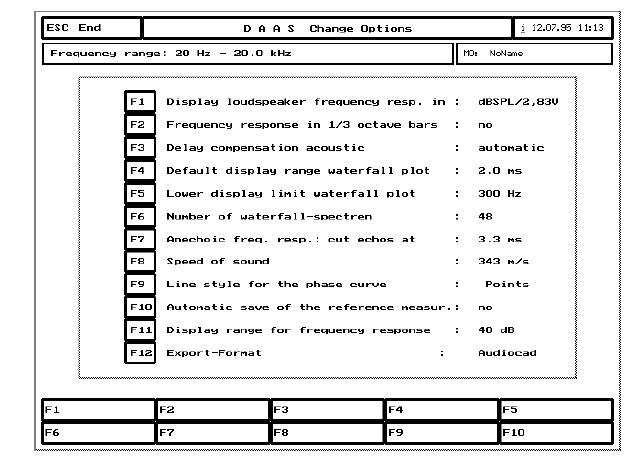

4950514ttz 发表于:2007-12-1 9:15:32
多谢!但在DAAS3L是CALSOD格式,不知是不是本公司的仪器有问体。还是在DAAS3L中设置不对。那要在主菜单F10中怎样设置,测完曲线后是F3-F5-OK后F4保存对吗?

Acoustics 发表于:2007-12-1 10:02:38
DOS版截图不便.
先在主界面里按F10设置,再按F3设置输出格式(Export format)为Calsod(LEAP)
测试完成后,直接按F5输出(不是按F4保存,F4保存的格式还是DAAS的格式)

Acoustics 发表于:2007-12-1 10:08:16
这是另一个版本的,在F12里选择输出格式.
Data format for export frequency response curves and impedance curves. Four formats
are available:
1. AudioCad: Frequency curves have the extension ".AMP",
Frequency phase curves have the extension ".PHA",
Impedance curves have the extension ".IMP",
Impedance phase curves have the extension ".PHE".
2. CALSOD: Frequency curves have the extension ".SPL",
Impedance curves have the extension ".IMP".
8楼
Acoustics 发表于:2007-12-1 10:08:51
3. AkAbakâ: Frequency curves have the extension “.AKD“,
Impedance curves have the extension “.IMP“.
4. Database: hifisound database has the extensions “.DBF“ and “.FRQ“.
